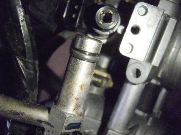

I was thinking about what you were proposing Zane with the 600RR secondary injectors in the airbox so I went on ebay to see what kind of money they are going for and ended up buying a set for €30 delivered from the states! Big Grin
[Image: P2040023.JPG]
This actually ends up serving a few purposes.
First is I will be able to test the EFI setup sooner and for less money. The injectors arent ideally spaced for the mc22 carb mouths but they should be good enough to test with anyway. The plan is then if this can prove that EFI will work well on the CBR250, I will go ahead and modify the GSR400 throttle bodies and make the whole setup more permanent.
[Image: P2040027.JPG]
Second is the injectors. They are a much lower flow rate than the GSXR750 ones (180-190cc/min) so they will suit the mc22 engine better. They are also the right size to fit into the GSR400 throttle bodies while the GSXR injectors just dont fit. Cheap set of injectors really! The 600RR injector is on the left.
[Image: P2040017.JPG]

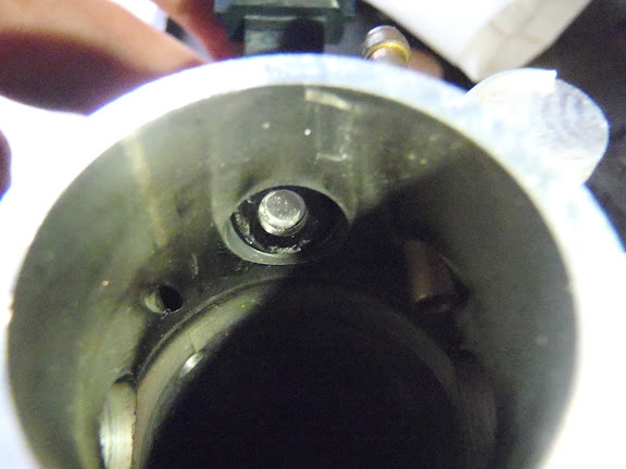

The GSXR throttle bodies will still serve a purpose though. The fuel rail on them is made up of 4 plastic injector fittings joined together by aluminium pipes and o-ring seals. It will be easy to make new alu pipes on a lathe to match the new spacing and an adapter plate to fix the injector fittings to the throttle bodies.
